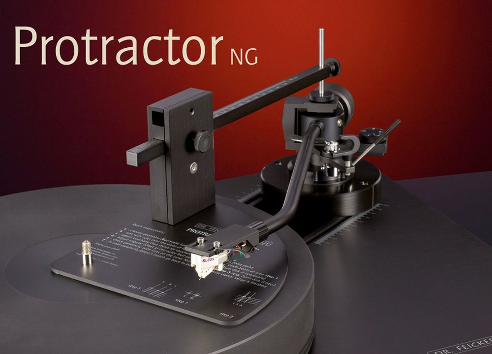

cozzy Posted June 26, 2020 Share Posted June 26, 2020 Кто подскажет по какому протрактору настраивать головку на Yamaha gt-750 с тонармом YA-39. Effective lenth 262 mm Spindle to pivot 248 mm Overhang 14 mm Offset angle 20 1 Quote Link to comment Share on other sites More sharing options...
irharry Posted June 26, 2020 Share Posted June 26, 2020 4 минуты назад, cozzy сказал: Кто подскажет по какому протрактору настраивать головку на Yamaha gt-750 с тонармом YA-39. Лучше по Dr Feickert Analogue alignment Protractor . Quote Link to comment Share on other sites More sharing options...
Moon1 Posted June 26, 2020 Share Posted June 26, 2020 Только что, cozzy сказал: Кто подскажет по какому протрактору настраивать головку на Yamaha gt-750 с тонармом YA-39. Effective lenth 262 mm Spindle to pivot 248 mm Overhang 14 mm Offset angle 20 https://www.ebay.com/itm/Yamaha-YA-39-YSA-1-GT-750-1000-2000-Tonearm-Cartridge-Alignment-Protractor/113601511059?_trkparms=ispr%3D1&hash=item1a732d7e93:g:89gAAOSwJvVcTjYQ&enc=AQAFAAACcBaobrjLl8XobRIiIML1V4Imu%2Fn%2BzU5L90Z278x5ickkAgU0umhwUTmgTFbE5cu7zUt9vfavrvB9b%2Fndsg%2FjgC5gttl2IPMAuHZK4fKby2fHKY1ADasZvf6bY17Vp6FNXmi2m51Lngd53b9W1zlxIVFSSt%2BoAlT84Xcn9K8d9vnxVdKAhgSRrSx5d4tU7U0AWjIQOz6GoyqWaYCcNDvqFdnxr6cLAwql2oc9DHJvltYJWp8LzaJg8kJfvOWchYaHlew7%2BSCrcj9SbY6bWuJyl%2FcMm9WzoScxFeWJJZ%2Fm72byy3gYaIiX%2FWLkx9suHxUTq6HgH4PY9WsiQf6hy1TSF8X96%2FY49Ei0rxbpv%2FB885SJOx6TFmEILa0LZyi6YFg92mY%2B7nN1Ch8eggahT9LKnnog8gAVfFrfAnjmE%2Bdj4%2FplgEc0a4MSRq4Xapu9TRCeqLsY4xxTj4BQHC6yKRwk9J%2Bw4aDUMidIXKG5a2qIvRsU7j4uOA3qZ0OMkLr%2BEJGtgJurvua47rqEiObGRYV4J6aANDGEyoOh0ALLdRPlyhzlLlUIeIA%2B6dU8th9Uxb%2FXPTcAsG7TlY09x%2F7QpmNpyJKp6RHbUD4Q8Yb4sdKquNuKqnxncgHYTgzyi8MjUZA4ZhsTI45Q7qI7WjxQqt0HHBRf0B65j%2FGq8fwjTMnzEzgDMXb8KTclB8ktgcb6Bsdk2tH8WOyaH3pehXy1NwHTD77OcsEQxKuIMCo0U%2BdnDMynPvEG%2F824EqlG%2BWYTkrSbwnkXTT%2BV4J62x%2BahiHMmFE7hmoCuSXqzcCToQtIv1L9xiRDTDmKoN2c0LexdL9dgcQ%3D%3D&checksum=1136015110599d91435f4a094d119d1f101a0bc08503 Quote Link to comment Share on other sites More sharing options...
igarr Posted June 26, 2020 Share Posted June 26, 2020 21 минуту назад, cozzy сказал: Кто подскажет по какому протрактору настраивать головку на Yamaha gt-750 с тонармом YA-39. Effective lenth 262 mm Spindle to pivot 248 mm Overhang 14 mm Offset angle 20 Все перечисленные товарищами выше - хороши, но думаю, что указанного производителем вашего тонарма показателя Overhang в 14 мм вполне достаточно Просто обеспечьте 14 мм, если тонарм имеет 2 прорези (саерху и снизу), просто перевернув шёл при установке иглой вверх и измерьте расстояние от pivot (центральной точки тонарма) до иглы. Только аккуратно. Если тонарм позволяет завести себя за шпиндель, то просто отмерьте 13 мм от центра шпинделя и установите тонарм на этом расстоянии, на пластинку он упадёт в 14 мм. штука, которую @irharry предложил - очень удобная и хорошая, но денег стоит, зараза... 4 Quote Link to comment Share on other sites More sharing options...

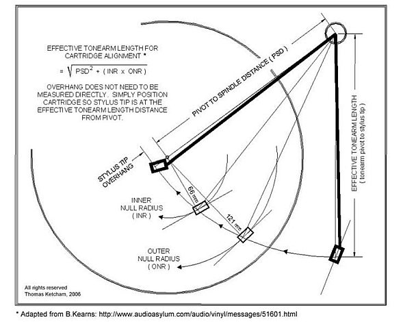

cozzy Posted June 26, 2020 Share Posted June 26, 2020 А если на основании вот этих данных https://www.ebay.co.uk/itm/Yamaha-YA-39-YSA-1-GT-750-1000-2000-Tonearm-Cartridge-Alignment-Protractor-/113601511059 В программе Arc Template Generator можно построить и распечатать протрактор Spindle to pivot distance 248 mm Inner Groove Radius 54.175 mm Outer Groove Radius 150.558 mm Print Arc Template: Confirm Parameters: Inner Groove Radius= 54.175 mm Outer Groove Radius =150.558 mm Spindle to pivot distance= 248 mm Inner null radius=59.779 Outer null radius=119.439 Effective lenth=262.000 Overhang=14.000 Quote Link to comment Share on other sites More sharing options...
cozzy Posted June 26, 2020 Share Posted June 26, 2020 Вот это настройка Overhang? Quote Link to comment Share on other sites More sharing options...
Niksem99 Posted June 26, 2020 Share Posted June 26, 2020 Нет. Оверханг длина от кончика звукоснимателя до середины яблока (шпинделя вертушки) Обычно на транспортирах его нет Quote Link to comment Share on other sites More sharing options...
Cottagelife Posted June 26, 2020 Share Posted June 26, 2020 41 минуту назад, cozzy сказал: Вот это настройка Overhang? Quote Link to comment Share on other sites More sharing options...
cozzy Posted June 26, 2020 Share Posted June 26, 2020 Спасибо по Overhang все понятно. 1 Quote Link to comment Share on other sites More sharing options...
