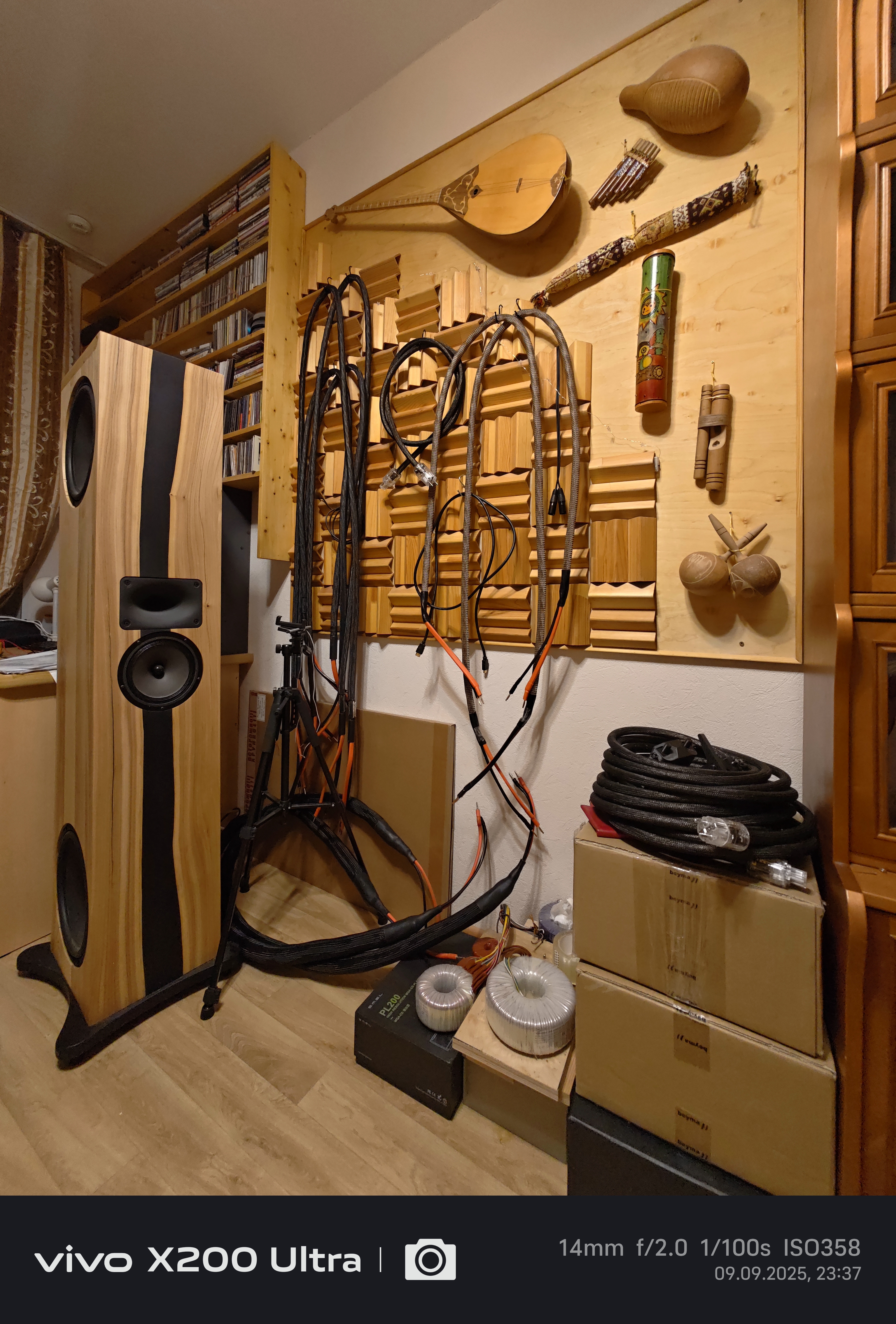

Moderators Popular Post Staudio Posted September 10, 2025 Author Moderators Popular Post Share Posted September 10, 2025 Атмосферненькое фото вышло 11 Link to comment Share on other sites More sharing options...
