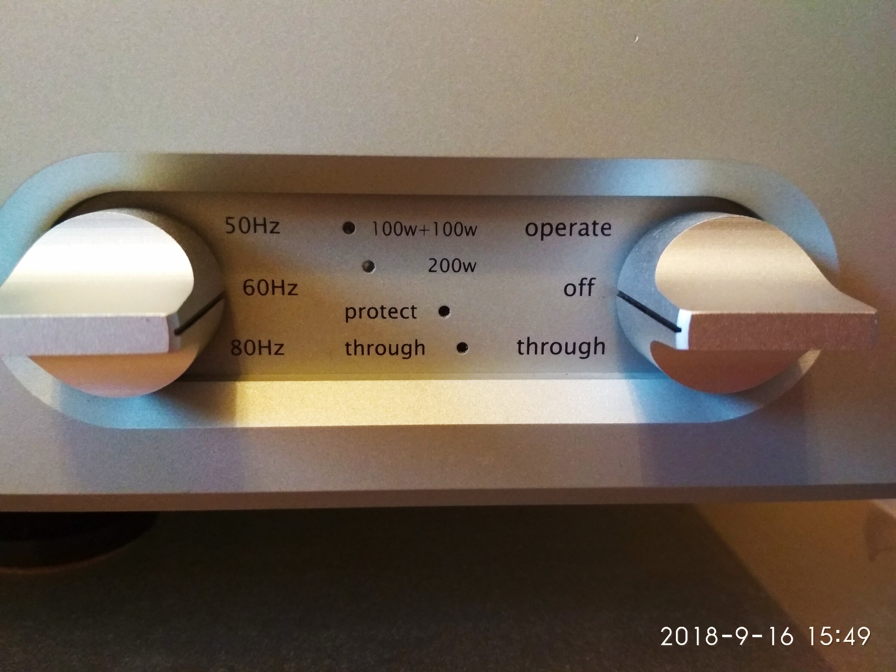

Васильев Игорь Опубликовано: 16 сентября 2018 Поделиться Опубликовано: 16 сентября 2018 После долгих взвешиваний и раздумий купил регенератор CSE RX-200100. В описании подкупило It converts AC 100 V internally into direct current and stores it in a large capacity condenser. "Storing electricity" is a big feature of the regulator. We will create new exchanges with that electricity. By doing so, you can create a noiseless waveform and keep the output voltage constant at all times, If it is called a large capacity regulator it will cost. Although the rate of change will change in the power supply environment, especially when used for the former stage equipment, S / N improves, It becomes high resolution. тех данные Output frequency switching: 50/60/80 Hz Through line function Rated output voltage: 100 V. AC (within ± 1 V) Pre-stage equipment (CD player, preamplifier) Isolation regulator reference model 100 W × 2 independent power supply system using WB transformer Since the output voltage is always 100 V ± 1%, stable electric power can be supplied even in regions where the voltage fluctuation is intense. The output frequency can be freely switched regardless of the input frequency regardless of the frequency of 50 Hz, 60 Hz, 80 Hz. It is also possible to convert 100 W × 2 lines ⇒ 200 W × 1 line and send powerful power supply. Stable sound is realized by firmly fixing with the included socket-fixing bracket. ※ What is WB Transformer A coil bobbin type winding iron wire transformer, a transformer of a reversal idea of winding an iron wire in a coil. The iron core of the WB transformer is made by winding a piece of grain-oriented silicon steel plate, and there are no cut surfaces and cuts. Therefore, the leakage magnetic flux is small, and noise and vibration are less likely to occur. Compared with the conventional transformer, which is about half the size of the conventional transformer but small in size, It is about 2 times regulation. Имеется возможность менять частоту(мне это как бы и не надо) непосредственно во время работы. Так вот-изменение частоты питания на слух не слышно)))) Запитываю от него источники Sony HAP-Z1ES , Sony SCD-XA5400ES и Phasemation EA-300. Синус у меня кривой, с регенератором идеальный-но на слух особого влияния не слышу. Все питается через развязывающий транс на 3кВ. Может просто хорошие БП стоят в источниках?))) Фразу, так горячо любимую продвинутыми аудиофилами-система не позволяет услышать-не повторять)))) Ссылка на комментарий Поделиться на других сайтах Больше способов поделиться...
Crossfire Опубликовано: 16 сентября 2018 Поделиться Опубликовано: 16 сентября 2018 Сложный БСО попробуйте с регенератором послушать и без него, причем физически убрав из сети, а не крутилкой на корпусе.. интересно... А вообще, по идее, ну на фонокорре-то должна быть разница (при включенном регенераторе и на женском вокале). Ссылка на комментарий Поделиться на других сайтах Больше способов поделиться...

Васильев Игорь Опубликовано: 16 сентября 2018 Поделиться Опубликовано: 16 сентября 2018 2 часа назад, Crossfire сказал: А как это можно понять "кустарным" способом? Самое неприятное проявление, как правильно отметил Константин-гудение торов. Если у вас этого нет, то и не думайте про нее. Ссылка на комментарий Поделиться на других сайтах Больше способов поделиться...

dimo61 Опубликовано: 18 сентября 2018 Автор Поделиться Опубликовано: 18 сентября 2018 В 16.09.2018 в 17:08, Васильев Игорь сказал: Синус у меня кривой, с регенератором идеальный-но на слух особого влияния не слышу. Все питается через развязывающий транс на 3кВ. Может просто хорошие БП стоят в источниках?))) Фразу, так горячо любимую продвинутыми аудиофилами-система не позволяет услышать-не повторять)))) развязывающий транс какой? с пониженной индукцией намотан? на каком расстоянии от стены у вас стоят колонки? по короткой или длинной стене стоят? Ссылка на комментарий Поделиться на других сайтах Больше способов поделиться...
